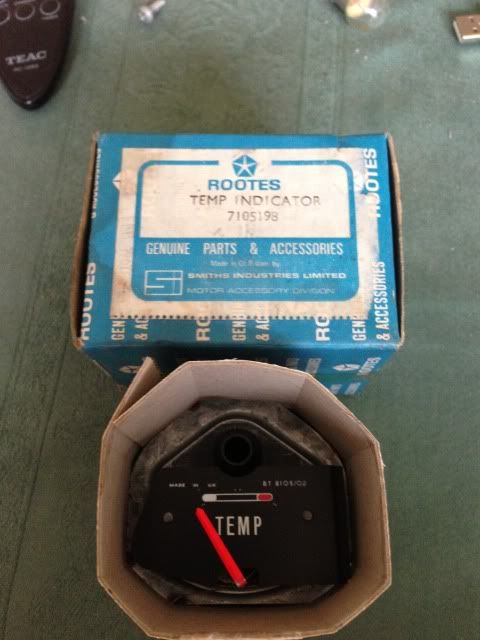

This is what you need, available from Speedy Spares @ £6.50 + VAT (according to the price list on the internet).
