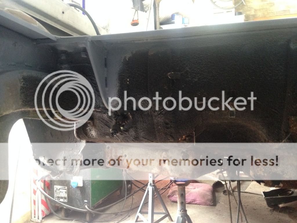

Following on from my last post, I’ve done a little more on the rear arches, and snapped a few pictures. Inner arch was rotten and had been previously repaired with a new arch tacked on top of the rusty original metal. I tubbed the inner arch up and joined it to the rear wing. So the outer arch is only single skin.
http://s661.photobucket.com/user/cs2605 ... sort=3&o=3
http://s661.photobucket.com/user/cs2605 ... sort=3&o=4
As you can see here a lot of the inner rear wing was rotten too, I’m undecided whether to add some thin wall tube to support this area and the rear corner, repair with thin sheet as near to original or neaten it up and have part or rear inner wing removed, any advice would be appreciated.
http://s661.photobucket.com/user/cs2605 ... sort=3&o=5
