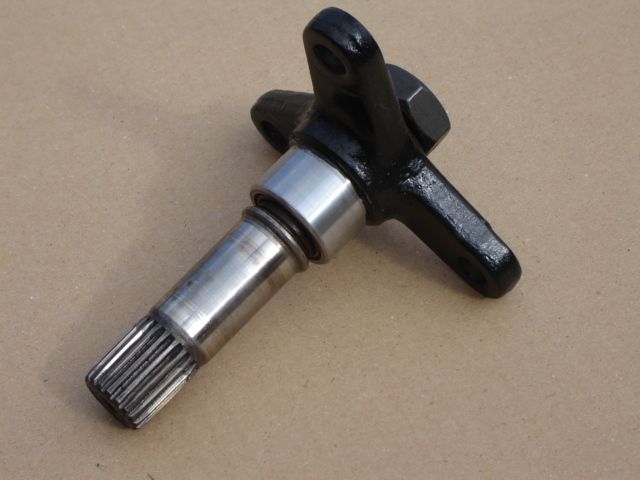

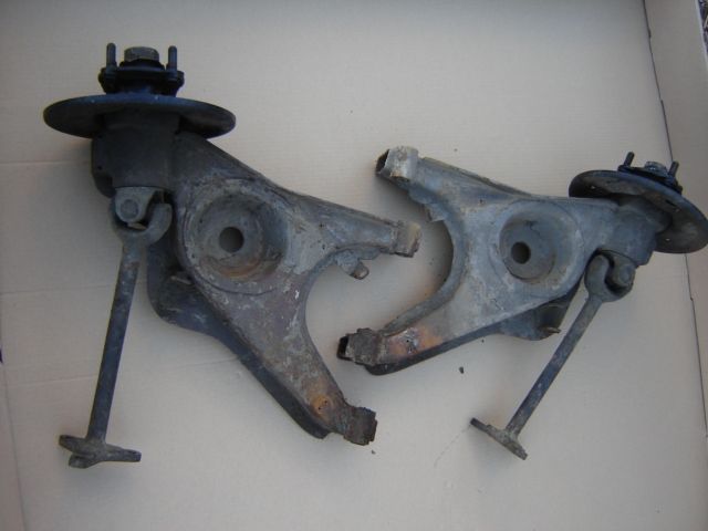

Rear suspensión and driveshafts now removed from the car.
The Wheel bearings and the universal joints seem to be fine. Will dismantle and send off the driveshafts and rear wishbones to be cleaned and powder coated. The rear brakes were binding when I got the car and I found a leaky Wheel cylinder on the drivers side. I will be fitting new Wheel cylinders, brake shoes, springs and flexi hoses to both sides when I assemble it all again. Found an oil leak on one side of the gearbox/differential and one of the "doughnuts" covered in oil. The other one looks a bit dry and cracked so I will be replacing both of them for peace of mind.
The oil leak was caused by a worn drive coupling. There was a nice deep Groove on the shaft where the oil seal fits. Have new oil seals ready to fit for re-assembly. The shaft has been built up and machined back to its original size again. Very pleased with the job they did.
Once I get the bits back from bieng powder coated I can put it all back together again. Have new rear shocks and Monte springs ready to go on also.

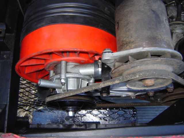

Regarding the air filter - that sounds like the same setup that was used on Imps in Australia. If it is the same the filters are still readily available here. A Ryco A89 is the appropriate one.
Russ Maddock
'69 Sunbeam Imp 930 Sport
'63 Sunbeam Alpine
'12 Polo GTI
Spanish Singer
Posts: 176
Joined: Tue Mar 12, 2013 5:56 pm
Car Model: Singer Chamois 1967
Location: Costa Blanca, Spain
Re: Singer Chamois found in Spain
Post by Spanish Singer » Thu Apr 25, 2013 10:11 am
sunbeammadd wrote:Regarding the air filter - that sounds like the same setup that was used on Imps in Australia. If it is the same the filters are still readily available here. A Ryco A89 is the appropriate one.
That,s very interesting news. I could PM you some photos of the filter assembly and maybe you could let me know if its the same model. I dont have the original air filter element for reference as it had the wrong element fitted when I got the car.
Thanks, Paul.

I'm not sure if the air filter set-up on your car originated in Australia, they tried a couple of different setups here finishing with what you have described - which may validate the 1967 date - I have a 1966 with the prior setup where the air was drawn from vents under the rear window.
That filter is a Ryco A89 (an Australian brand, other manufacturers may do it also), 91mm inside & 149mm outside diameter, 128mm height.
Available here (in theory) for $AUD27 - http://www.onlineautomotive.com.au/A89-Ryco-Air-Filter
If you have trouble ordering one due to your location, let me know and I will try to help. I said 'in theory' earlier as I'm not sure whether they will actually be available, I bought one probably 15 years ago which was 'old stock' and haven't tried to since.

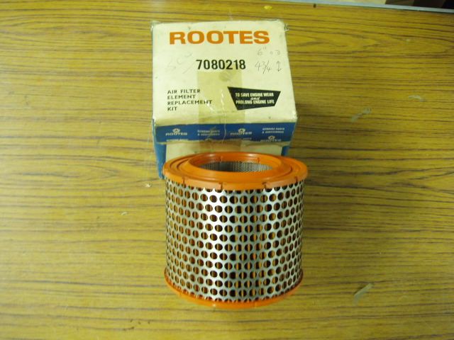

Thanks to you guys out there in Aussie for your help. The air intake below the rear window sounds interesting, any pictures ???
Here is a picture of the original Rootes export model air filter
Thanks to Magic Malcolm I now have a new filter on its way to me :D Having said that, the filter that is available there in Australia looks like the right one also.

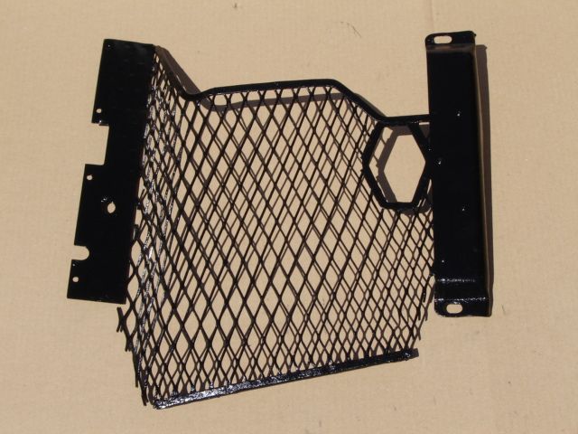

I was wondering, out of curiosity, if the stone guard fitted to my car is a common fitting on our cars or if its an export only part. Its fitted under the car between the radiator and the rear valence, under the water pump.
It effectively closes the gap between the inner wing and the engine sump. Just wondered if it was a part fitted to all cars ??

That was fitted to the early Sports in the UK, and was got rid of later, probably as a cost cutting weight reducing exercise.
Imp Sport and Chamois Sport also use the rear stoneguard when the B Post air intake is fitted and also it was fitted to Heavy Duty models
Parts book states:
Export models
B492 B792 Sport and Chamois Sport
B301 Stilletto
And certain Van and Husky's
They are a bit hard to come by now too as many have rusted away, been damaged or got thrown away to make it easer to remove the rear panel, nice to have if youve got a good one. And of course the radiator needs the fixing bracket on the bottom too to fix it.

Thanks for the info Peter, its amazing the amount of knowledge that's out there amongst our club members.
The stoneguard came fitted to my car from new. Its a LHD Singer Chamois but not a Sport. It does have the air intake on the door B post with the export air filter. The brackets on the radiator are part of the radiator (welded on) so I guess there must be a different part number for this model of radiator as well.
The stoneguard is in good condition and, as can be seen from the picture, I have just re-painted it ready for when it goes back on the car.

Yours is an export model so no doubt it was classed as a heavy duty version, filter and all.
And yes the rad is different and you dont see many now about with the extra flat on the bottom for the guard, tends to get discarded if the rad is ever rebuilt.

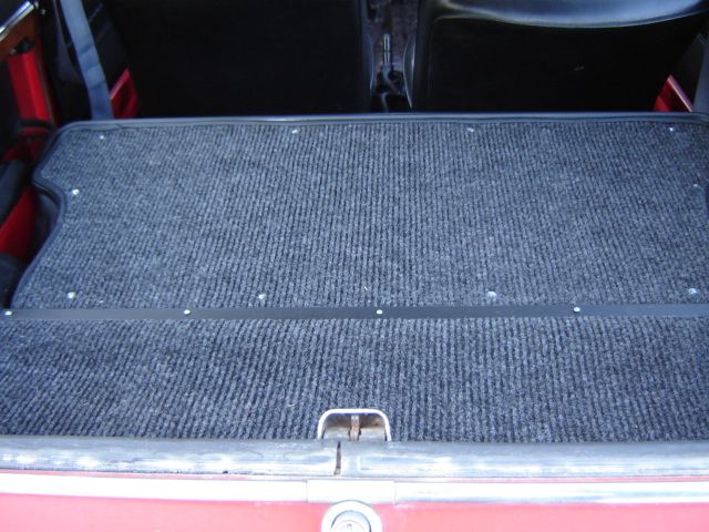

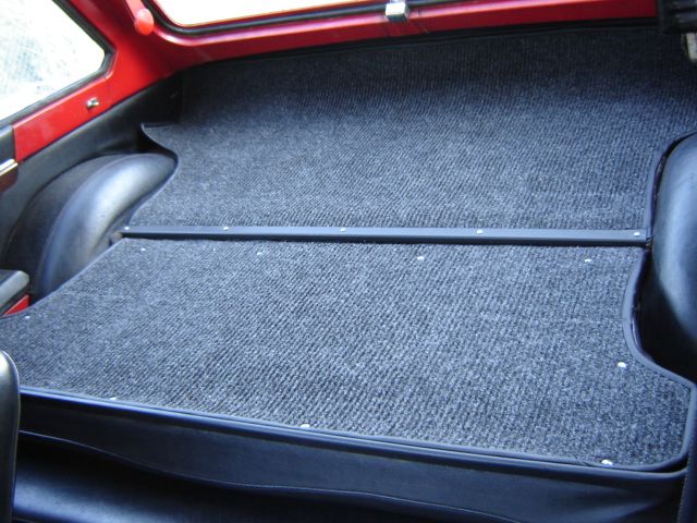

Started putting the interior back in the car although had a bit of a setback the other day. The car is outside, uncovered, and we had a good old Spanish downpour. End result was all my new soundproofing soaking wet :( . Knew that the rear window leaked, but didn't know that both doors leak as well !! Its taken a few days of sunshine with doors and back window open, to dry it out. I have now put a waterproof cover on it, better late than never :D
Have now put the rear seat back in the car. The original rubbers from the seat back and rear shelf were cream crackered so I had some replacements made from heavy duty carpet.
Need to find a good pair of seat back retaining straps and chrome bolts from the seatback to hold them, missing from the car for some reason.
Very pleased with the end result, a good replacement for the rubber.
Next job is to finish fitting the carpet and the front seats.

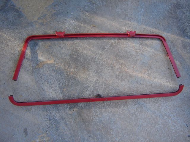

Decided to attack the leaky rear window problem. After advice from here on the forum I removed the window from the car. The next step was to split the frame. After removing the lower part of the frame from the glass I found that the glass was well glued in to the top part of the frame with some kind of mastic. I carefully cut round the glass to frame joint with a sharp knife to try to free it up. I was worried about forcing it and breaking the glass, so went very very carefully.
Finally the glass came free from the frame. After removing the old mastic from the frame I see that the glass enters the frame easily. When I re-assemble it I will be using Sikaflex to seal it but I think I will strip and re-paint the frame first.

Have now got the rear window frame back to bare metal and ready to respray it.
The car has had a colour change from white to red in the past so I have no colour code for the red paint. I have removed one of the door pockets from the inside of the car as the paint on this part of the car is as new and not faded. Hopefully can get a good colour match from that.
Paul Imp011 Imp009

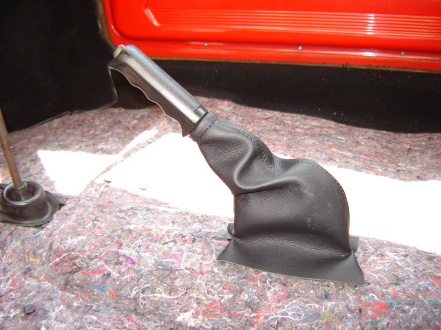

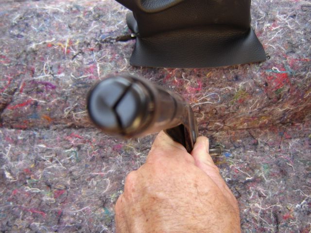

Have just replaced the handbrake lever on my car. The original one had the wrong plastic handle on the end and it was loose. The "press to release" button on the lever was also split. When it was depressed it jammed in and so the ratchet mechanism couldn't operate.
The replacement lever now has its correct handle and a posh new leather sleeve made to fit it too.
I am still half way through painting my rear window frame. The primer and the paint went on great but when I put on the clear coat of varnish something went wrong. Its got a case of "Orange peel" finish in the varnish (couldn't be anything else in Spain really :lol: ) Need to rub it down and re-paint it once I've figured out what I did wrong ???
Imps never had a 'handle' from the factory. They were always supplied with a bare, painted steel lever. The grip fitted there is not original - but looks like an aftermarket accessory (I remember such things being sold in small independent Motoring Accessory Shops from my youth).
8)

Thats interesting to know, I brought it off e-bay, described as an original handle for the Imp. Not to worry, am pleased with it and it looks the part, fits perfect, nice and tight.

To be honest, Paul... they are much nicer!! 8)

Me too Tim. Its not original, but at least its a "period" extra and not a modern addition.
Also its a nice big handle to grab for the handbrake turns :lol: :lol: :lol:

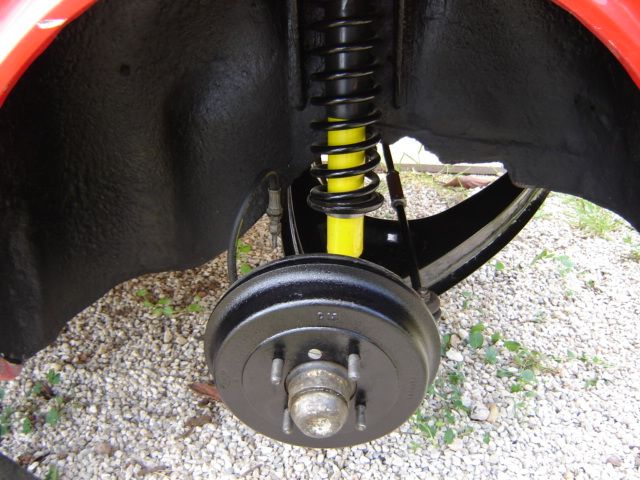

Post by Spanish Singer » Mon Jul 15, 2013 5:23 pm
Finally got the rear suspension finished and back on the car. Did a complete rebuild so that I can tick off this part of the car.
Have fitted new shocks and Monte springs, new UJ´s and drive couplings too. The rear brakes have new wheel cylinders, new horseshoe clips, dust cover, new springs, new shoes and new flexi hoses. Rear wheel bearings were good so they were cleaned and re-greased on assembly with a new grease seal fitted to the hubs.
Hopefully this area of the car shouldn´t give any problems now.

WSM says fully tighten up rear adjusters and slacken front.
Start right hand rear then left rear then right front and finally left front.
When bleeding it says depress pedal in a series of long and short rapid strokes letting pedal fly back to stop wth foot removed.
Always keep master cylinder reservior topped up. It only takes about three pumps to empty it IIRC.

Just had a bleeding good Sunday afternoon :lol: . Have bled through the braking system and have a good feel on the brake pedal. Have adjusted the brake adjusters on the front.Just need to adjust the rear brakes and connect and adjust the handbrake cables. In theory the brakes are now ready but the car is not driveable yet so the road test will have to wait. Next job re-install the fuel tank and start work on the engine. Another thing ticked off the list :D

car is looking goo, couple of tips for you lock up the rear adjusters solid and back the fronts right off when bleeding, when bled adjust up correctly, and dont forget to fit the big clips on the rubber fan shroud, the fan is very powerful and will balloon the rubber shroud causing air leaks and compromising cooling it is an amazing amount of air that will bounce back off the rad fins and take the easiest route to escape. basically reducing the amount of air going through the rad which will lead to cooling troubles. sorry if you are aware of all that!
Regards Moose

Thanks for the info. I have bled the brakes and all seems to be good. Cant road test the car yet but the pedal has a good feel. The front and rear adjusters are now set right and the handbrake cables are also adjusted now.

Started bleeding the cooling system today and soon found out the I have a water cooled fuel tank :x The heater valve and the steel elbow that it is mounted on looks like a modification and not original. The brass valve is stuck open and the steel elbow has a pinhole in it, which sprays the fuel tank with coolant.
I have removed the elbow/valve assembly and bypassed it with a piece of steel tube for now. Don't know what the original heater valve assembly looks like so if anyone could post a picture of an original one I would be most grateful.
Now that I have had the engine running for a while I can see that it is smoking white smoke. Maybe the piston rings are stuck to the pistons after so much time standing. Hopefully when it has some use they will free themselves and its nothing more serious. Fingers crossed.

Spanish Singer wrote:Now that I have had the engine running for a while I can see that it is smoking white smoke. Maybe the piston rings are stuck to the pistons after so much time standing. Hopefully when it has some use they will free themselves and its nothing more serious. Fingers crossed.
Paul Imp009
White smoke usually means steaming water. I think stuck rings (and worn valve guides) would create blue(-ish) smoke.
With a bit of luck it's just a matter of fitting a new head gasket.

Paul, take a look at this (clicky). It is the results of an eBay search for London Taxi heater valves and the selection of images from various vendors should give you an idea of what they look like and how they work. These are not the same as the original Imp heater valves but many consider the Taxi valves to be much better made and longer lived. :)
For now, bypassing it should be fine.

Thanks for the link Paul, will look into finding an alternative as it seems the originals are not available.
