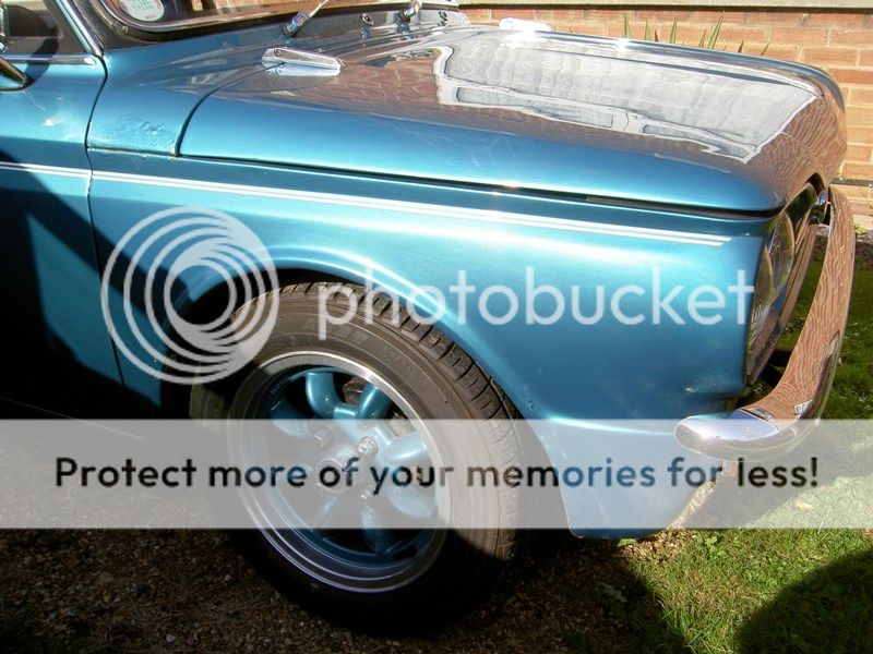

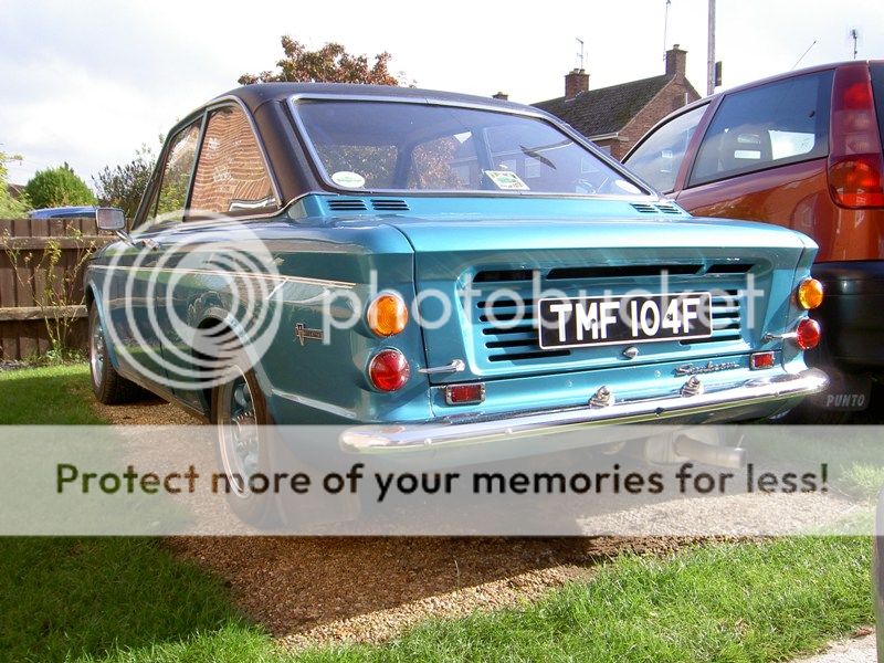

Here are the final photos of my Stiletto rebuild. :D
There have been problems along the way,and at times I've felt like giving up, as I'm sure many of you have too? :wink:
I covered over the original blown vinyl. Results were quite good and certainly look better than the cracked/missing sections underneath.
It's soo good to be able to drive the car again,and to fill up with petrol and have interesting conversations with people that would otherwise not say anything when in a eurobox modern. :lol:
Looking forward to taking the car to Perth in a few weeks for IMP50 yay!!
