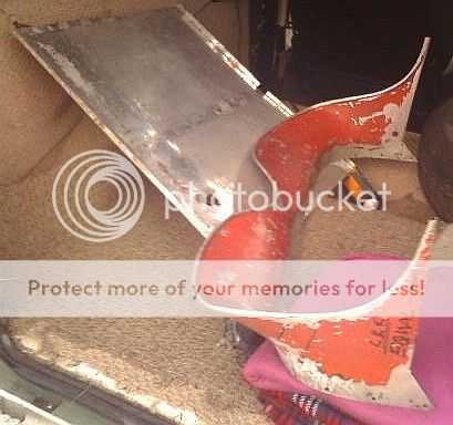

Hi all, this is my Special's beginnings The scuttle and back panel (in the back of the Reliant Fox van).
All dents and bumps removed with a planishing hammer and the English wheel at work. The rotten ash removed from the back panel.
Other pic is the engine in all its bits in the storage caravan with the body side behind.

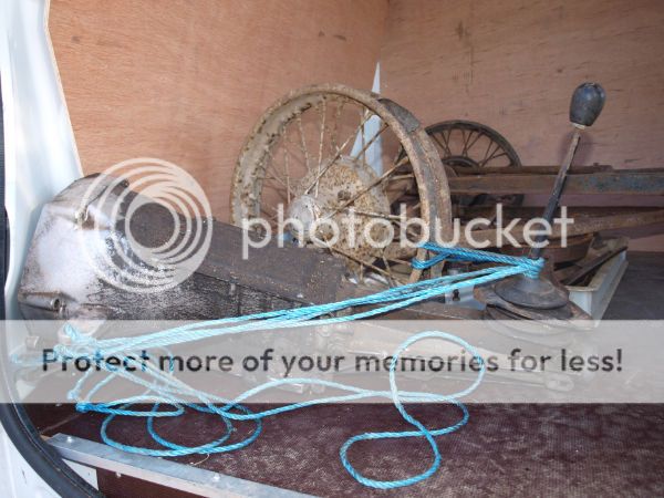

Hi all, here are a few shots of the newly acquired Austin 7 chassis for the Special.
Note how neatly it fits a Renault Trafic van!

Here's the Sunbeam gearbox from Dumfries.
The guy I got it from has an original Sunbeam with just 500 miles on the clock!!
This is a very neat,light unit with a nice remote change.

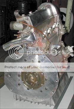

This is what my engine will look like. Unfortunately the pic of it in an A7 Special wouldn't download and the daft sod has removed the video from youtube as well! But it looks marvellous. I have also found that the Sunbeam engine weighs fully 50 lbs. less than the A7 lump, but it well over twice as powerful in bog standard trim! The above Coventry Climax unit is the VERY rare 750 cc unit as used at Le Mans in an Elite to win the Index of Performance and is for sale for a measly £4,500.. OHHH!!!!
Cheers,

Oh dear, what a huge gap in reports about this little project! As there probably will be from time to time.
I've just been very busy with earner jobs, fitting a wood burner, etc.
Extra to all the above is that I went over to the gentleman from whom came all the Cambridge body extras and picked up a superb, unused Bowdenex front suspension system. These were designed by and later sold by Cambridge. A twin spring unit with new Mini telescopic dampers. It's 4" wider track than the 7 axle, too, so comes with a purpose made track rod using Ford Pop ends, which don't fit the A7 steering arms, but nothing that a bit of lathery can't cure.
http://i461.photobucket.com/albums/qq33 ... d329eb.jpg
Meantime, I have repaired the back panel on a friend's English wheel which, apart from shaping, will also flatten dents and bumps in a single pass. I removed all the old dust that was once ash, redid the flanges on a steel bench using a hammer and old flatiron bought for pennies at a Boot fair.
Then I bought some 1 1/8th" square ash from a local specialist wood yard and re-framed the back according to the original pattern, though I went further with the joints to make a neater job. Just bandaw, and half inch chisel I bought when I restored my historic narrow boat. I bought 14 high quality chisels for £7 at the huge Staffordshire boot fair! Always buy tools at the "old tool stalls" at boot fairs as they're likely to be the best quality. My chisels are all either Marples or Sorby, THE best bar none.
Here's progress with the back panel. A Sunday afternoon's work recently.
http://i461.photobucket.com/albums/qq33 ... 1b0251.jpg
http://i461.photobucket.com/albums/qq33 ... 6e04bd.jpg

Finally, last night I did a great deal with an A7 supplier for these beauties.
http://i461.photobucket.com/albums/qq33 ... e5a8e2.jpg
I first fell in love with these when I was a kid staring in the window of the Essex Speed Centre on Seven Kings bridge! Speedex (later to become Marcos) wheels with four good tyres for a price I couldn't let slip. I'm picking them up on Friday. These were also sold by Cambridge when Speedex folded and are the same date as the body (1958).
