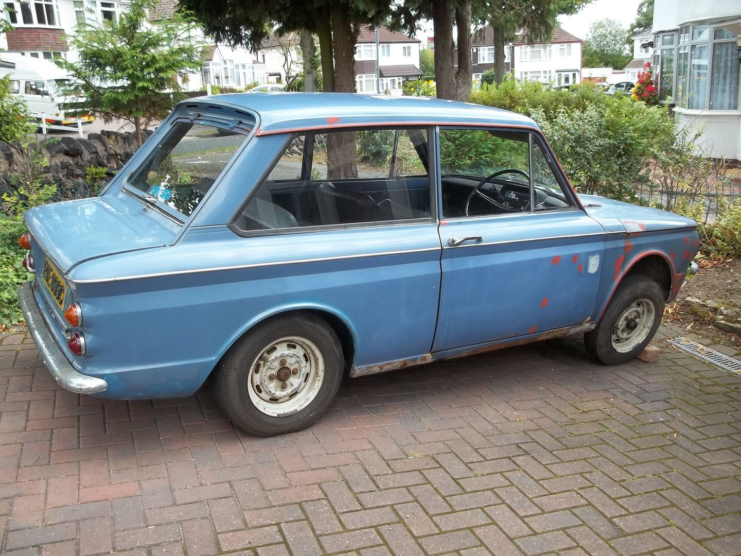

Thought it about time for an update.[imgImage][/img]
Only having a small garage which the imp shares with my Westfield build work is on one side at a time, with the car 2 foot in the air it's allso a lie down job which is good for me at 68 :lol:
Under front has had all the old underseal chipped off, de-rusted and stonechipped { no serious rust only surface}
all the front suspension, brake pipes and fuel line have been stipped out, new brake pipes, and fuel pipe have gone in.
front suspension has been stipped, powder coated and harder bushes. hubs have new kingpins, brake cylinders and shoes {may change to discs later depending on finances}. Have Malcomb's extra short monte's with Spax adjustable shocks.

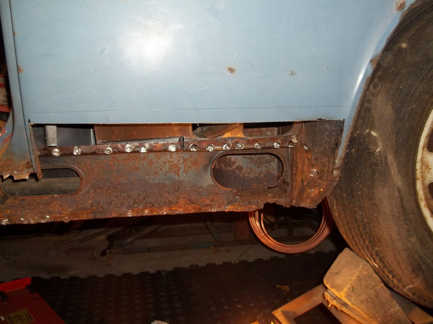

Only major rust on the N/S was the sill and rear under corner, luckily the inner sill only needed small repairs.

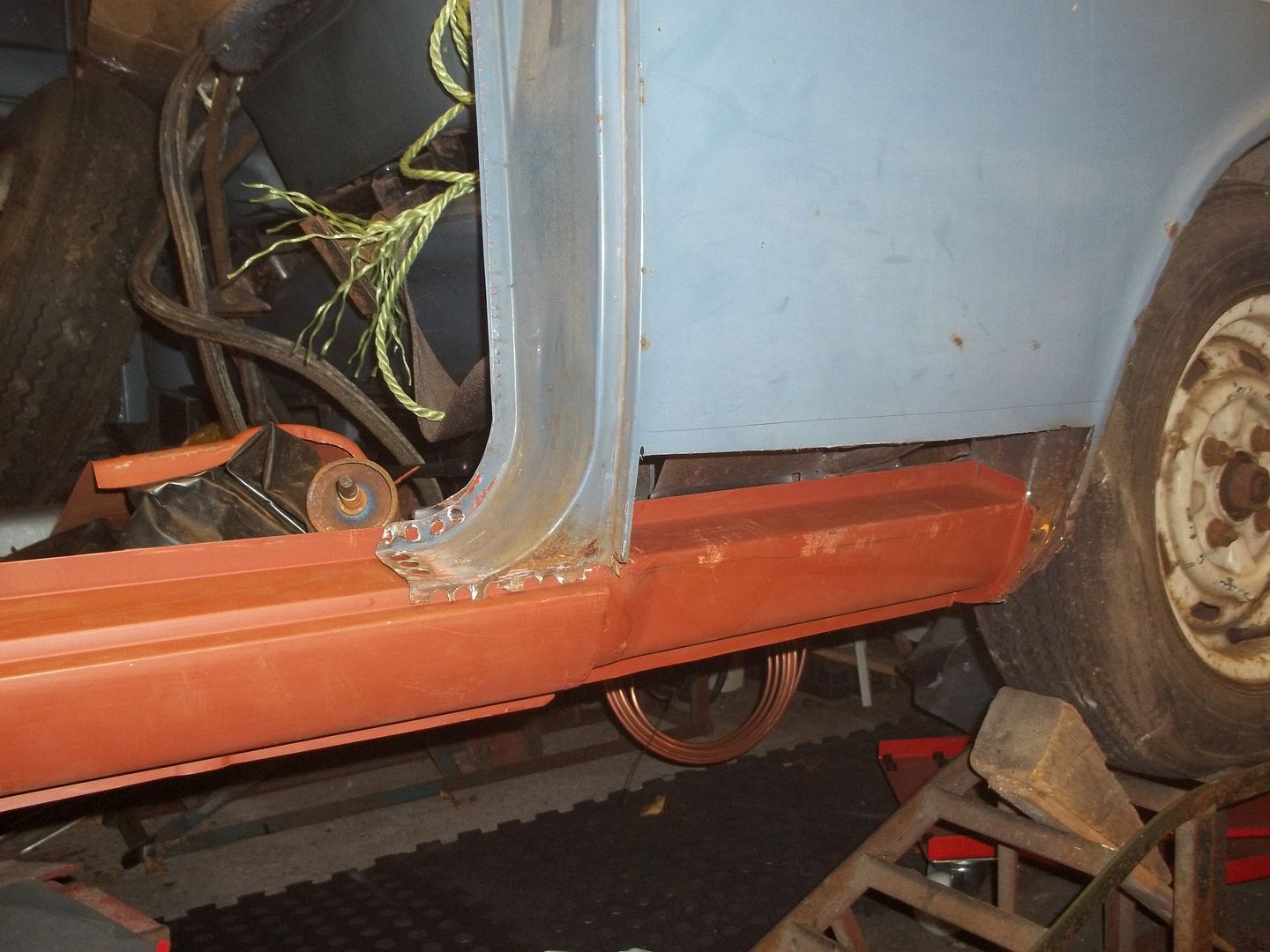

[urlImageImage][/url]
[urlImage][/url]

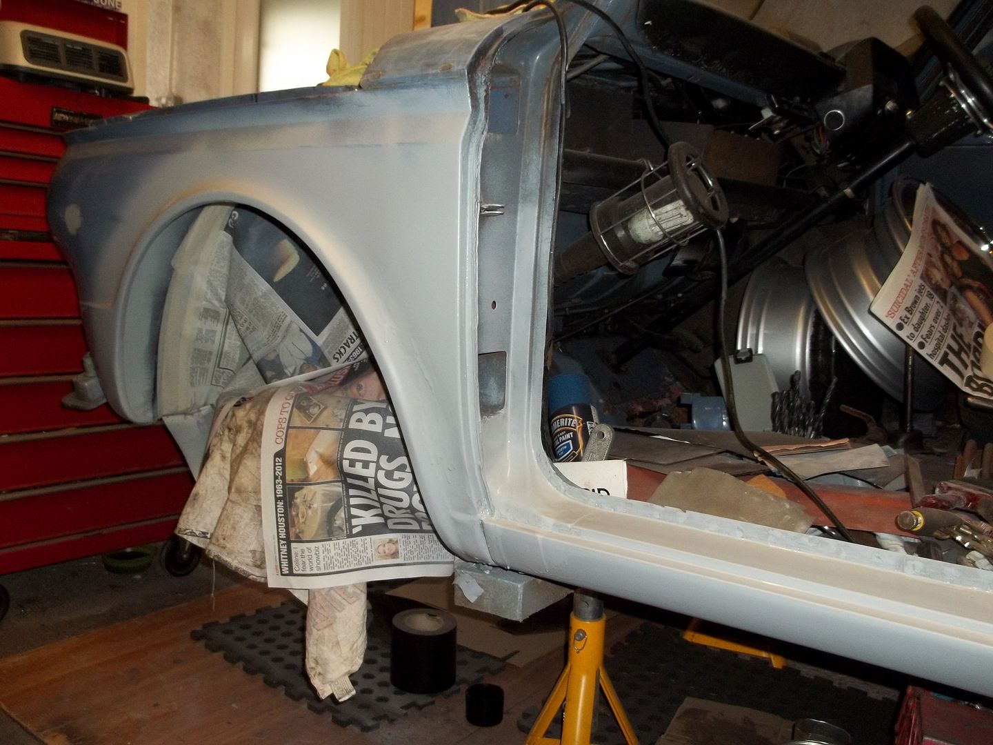

just a bit more with the inner sill/outer sill and wheel arch repaired.

Front end complete. bonnet was completely rotten all the way across the front, outer and inner so a replacement in fibreglass was made by Fibreclass. :D
luckily there was no damage on the windscreen surround, just cleaned up and a new rubber. new springs and blades on original wiper arms.[urlImage][/url]

once resumed the inner and outer sills were cut out and replaceed with new panels along with part wheel arches.
a fick of paint and all looks fresh again.
having problems with photobucket at the mo :roll: so here is the car now the body is rust free 8)
