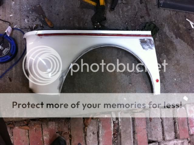

So, as I said in previous post, I have spent the last three days at the unit. Some good some bad!

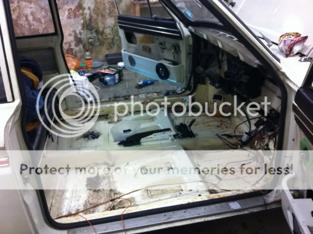

Interior is now stripped out, seats, carpet, dash. No real suprises, but floor seems solid so that’s good.
As for fitting the sill, I need to actually weld it too something. Some needed to inspect the front and rear inner arch’s. this is where it all got a bit interesting.

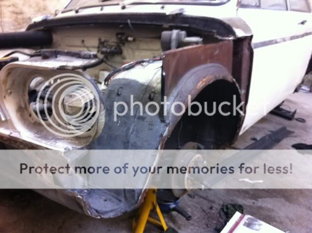

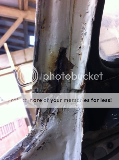

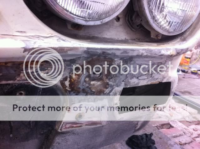

The back I knew would need a new inner arch, I already have it. The front though, well that’s not so much good news. Cosmetically from the outside the front N/S arch seemed good and I had no plans to start messing with it, until…the I found that the back of the wing wasn’t actually attached to the car!!! This was then pulled slightly to get this.
At this point I realised that the inner arch that I thought was ok was actually made up of filler, I mean about 95% of it! There was no lip return, just filled with filler. I was shocked with the amount of filler in that corner so did more research.

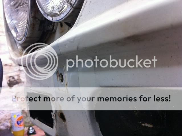

The front panel is not as it should, N/S isn’t square to the O/S, but then built up with filler to make look correct. Stripping the filler back you see how the front panel is in a sad state too.
This is the other side, showing a more distinct angle below the lights.
This can be fixed with either a front panel (if I’m lucky) or more than likely me fabricating something to replace it with, don’t think it will be too bad.

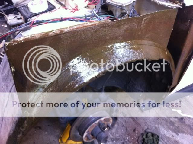

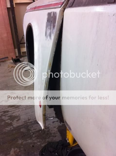

It was at this point I thought there is no other option. The wing is good, the inner wing is shot, what do I do? THIS!!!
This is the inside of the removed wing, showing signs of some rust but not showing on the outside so hopefully i have caught it!

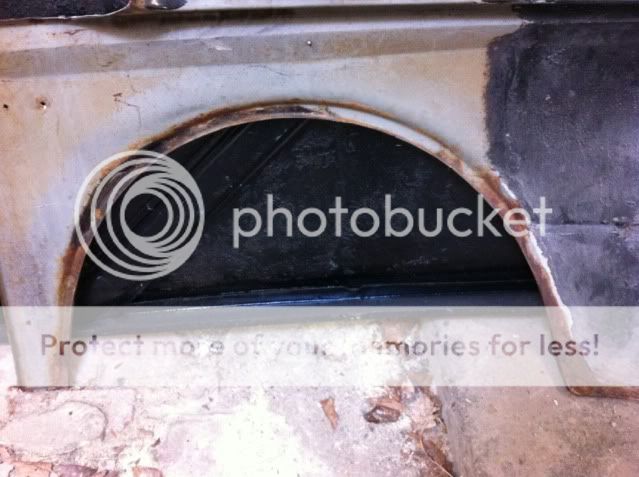

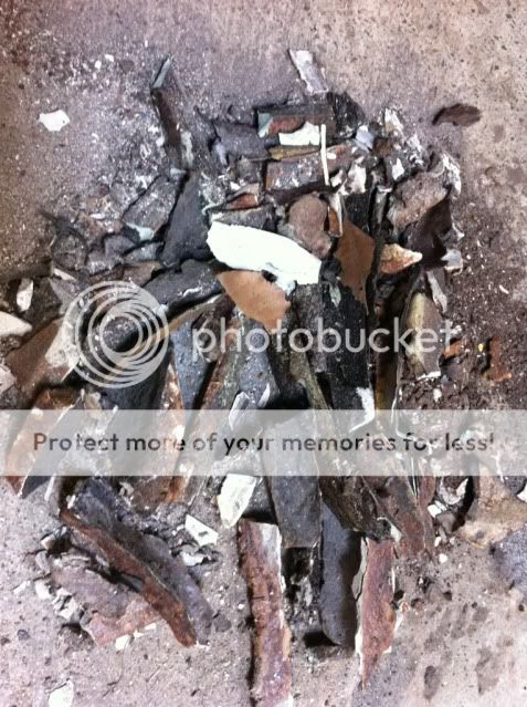

The inner arch showing it's age!
This confirmed how bad the arch was. See how much filler I got out of this corner!
The next problem is the valance panel has some rust, but nothing cutting and a patch can't solve

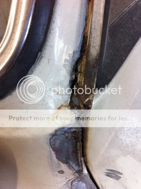

Another problem is the roof gutter line, it has had some bad work done in the past, filler is used a lot, thing is now that i have taken some of the filler out, i have been left with a hole, going straight through.

Those A-pillar sections look gnarly. :? They seem fiddly to repair to me but are very important for obvious reasons. They need doing, though, so wait for someone with experience to advise and get cracking. :wink: If you search around the Readers' Cars forum, you should find some A-post repair posts, I think. Does the Rootes parts manual show the construction in that area?

ImpManiac wrote: Those A-pillar sections look gnarly. :? They seem fiddly to repair to me but are very important for obvious reasons. They need doing, though, so wait for someone with experience to advise and get cracking. :wink: If you search around the Readers' Cars forum, you should find some A-post repair posts, I think. Does the Rootes parts manual show the construction in that area?
Yea i am hoping that i can get some advice on the pillar, as it does like it's going to be an a*se of a job. put it this way, i think that bit of work is above me, and may end up having that section completed by someone in the trade.

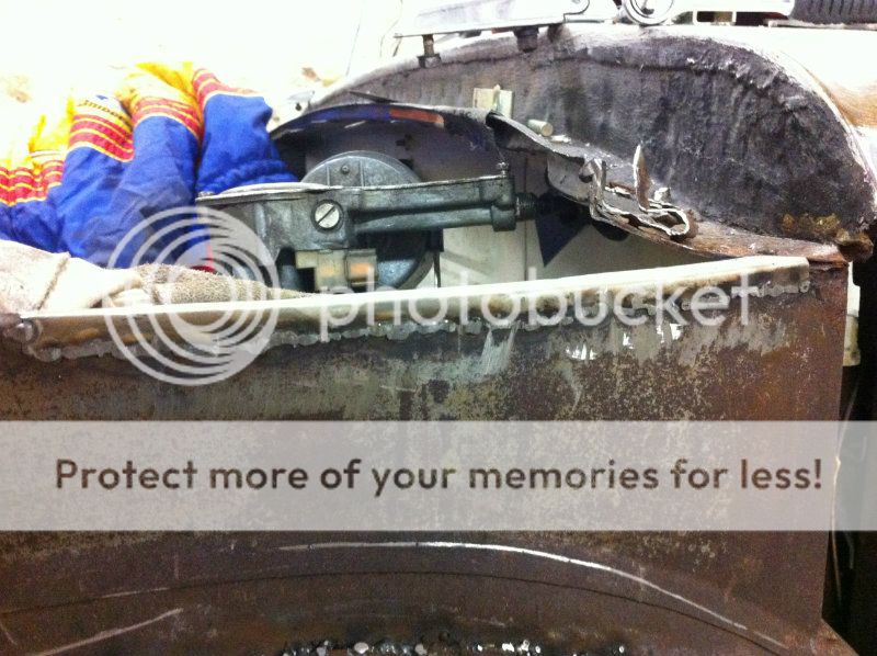

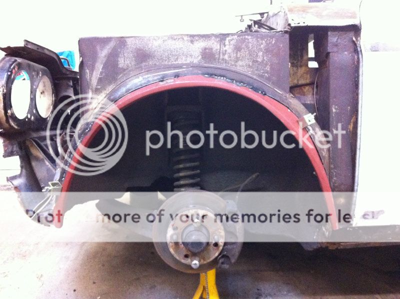

So with some more tinkering and playing around with the panels, we have progress!

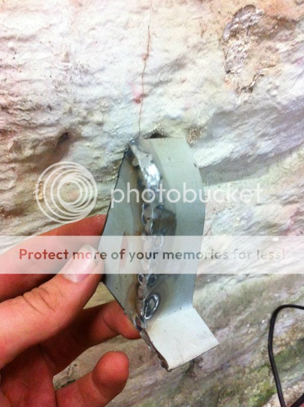

The first bit of welding has commenced! This is the first bit of welding I have done on a car, so I am happy but do see where I need to improve on, at least you won't see that when the wing is back on, but it is solid!
Need to go all the way round, but ran out of gas so that is fridays job.
Also got a front N/S corner which will get rid of the nasty warped front that is currently there.
Got an inner sill also, for one side, meaning that I can make the panel for the other side from it. looking forward to doing that actually! Thanks to Darren for those!

welding will improve with practice.just go nice and steady a couple of inches at a time(oh misses)

noel dont be affraid to turn the amps up a bit you will know when your to high with them when you pop a hole ,your best bet is to get a few bits of new flat metal same as what your useing on the car and do a run of weld then turn the power up a bit and go again until you have a nice flat weld ,sometimes you will find you may have to adjust the amps as you get power surges as in tea time the power coming into your garage wont be as good as say 10pm at night ,and when your happy with you weld then start on the panel your fitting do say half an inch and stop move a few inchs from that weld and do another half inch and so on until you get around the arch ,then leave it until it has cooled down ,i find its always best to have other work to be doing when doing say a wheel arch other wise you tend to want to get the weld on and dont realy let it cool enough

Colin. Cheers for the advice, i do practice on small pieces of sheet metal, seeing what penetration i'm getting etc. As for the AMPS, due to not having the best welder, i can't fine tune the power, it's either 1,2 or 3. i currently leave it on 1 as it just burns through on butt welds otherwise. When i come to plug welds i shall be turning it right up!
I have done a college course on how to weld so i understand it, but doing it in practise is something else.

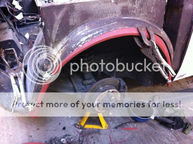

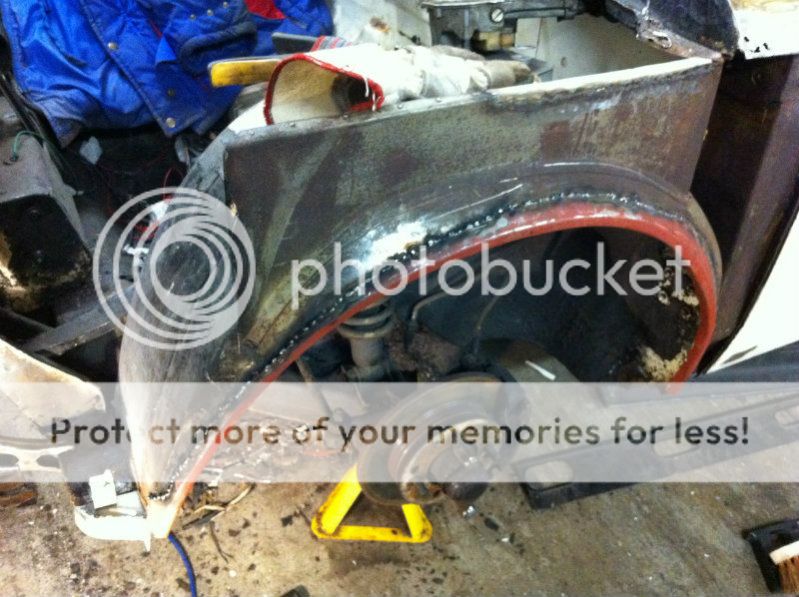

The inner arch is now fully welded into the car, ok it's not perfect and flat like it should be but it's v strong and my welding has been improving today, so i'm happy
Also welded in a new section at the top of the inner wing as this wasn't there when i took the wing off

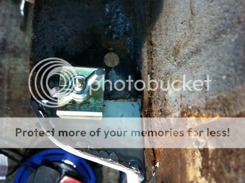

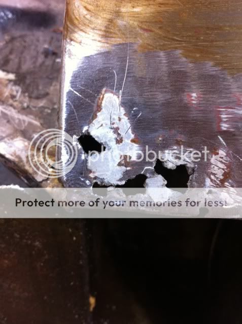

At the bottom of the front corner i found a fair bit of rust on the vertical so decided to fabricate a piece.
Very much like this, but me being me, i was that focused on making it strong i welded it on the at the bottom rather than at the top where in needed to be.
So i made another
ran out of time so didn't manage to get it fitted but it's ready to go in.
I feel like i've made some real progress today! :)

Firstly a thanks to Paul aka sammy the sturgeon for lending me the roller he made for Gladdis, Vickie feels honoured to be on a roller linked to Gladdis lol.
spent some time with the car this weekend, needed a mojo boost so i lined up the panels i have that need to be attached to the car, was an interesting exercise!
I need to make the inner sill for the passenger side and need the sill extension but you can see most of them are there and generally fit in place
find all the pictures here, i'm fed up of not being able to upload pics!
http://s416.beta.photobucket.com/user/s ... 7/profile/
I also messed with the fiesta arch that i will be using as the inner arch's, a good and fairly easy job
That's all for now but i'll keep you all posted!

super66 wrote:Firstly a thanks to Paul aka sammy the sturgeon for lending me the roller he made for Gladdis, Vickie feels honoured to be on a roller linked to Gladdis lol.
Your welcome mate, if it helps you, like it has me, it makes it all a little easier.
Just a little note on the twirler, wouldn't want any mishaps....
the 'T' piece handle that you use for turning - make sure you have both rubber handles on it as if you don't when you turn it, it could drop out and then the mount is free to part from the pivot (front left as you look at the front of the car in the picture).
And --- it may just be the angle of the picture, or that you haven't fully raised it up on the extensions yet, but in one picture it looks like the back is higher than the front, if you rotate it and its not level you might stress the front panel, and as there is no wing there yet for strength it might buckle it. wouldn't want any problems with it.
Good to see your mojo is back and there's progress, and trial fitting the panels is a good way forward don't be scared to use self tappers to hold everything in place, it helps you get it in the same place each time you fit, take off, refit, take off, trim,refit, take off, weld a joining panel, refit, etc, etc, etc, and you can always plug weld any holes from them, after you have welded the panel.

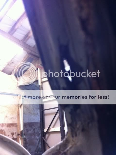

Well for the first time in a while, i have some actual progress to report on the car.
First thing though, i want to thank Chris for giving me a hand and his welding skill, i've got much to learn!
We ripped out the old inner sill and by the end of it had the inner sill and outer sill fitted to the car.
At all stages the welds were zinc primered and treated, The outer sill is welded in place, but not fully, i will be seam welding it all in.
Have a look through my pics on photobucket, sod changing all the aspect ratios!
