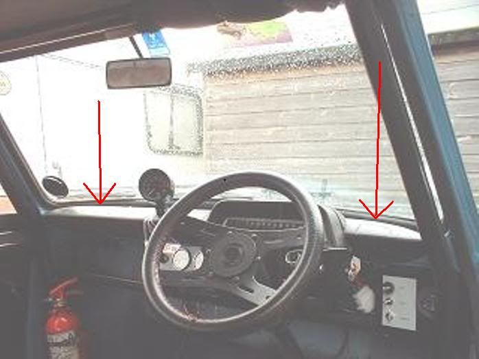

Finally got to take some pics in daylight when it isn't persisting down :D
Chequerplate floor & pedal extensions. Looks good but slippery when wet. Gotta go...
Interesting dash mod that might have worked if the wheel was lowered. Gotta go...
No diagonal, out of date harnesses and too many seats. All vgc but gotta go...

Rather than replacing the cage just weld in the diagonals and seat belt bars if required, same with door bars going to work out
a lot cheaper.
Keep the passenger seat and then you can do track days etc and show off to your friends and family :
Good luck

Chris Benoy, you mentioned recently that I'd need 2 bits of dash to go with the proposed rallye dash. Did you mean the brackets either side to bolt it to the facia or did you mean the 'crash bars' i.e. short one on the right & long one holding ash tray (cos of course I enjoy an oily rag mid-race) on left? There's a few clips on UTub sans crash bars so I'm presuming the brackets.
Cage is 36mm so will most likely go the whole hog and fit a 50mm. Harness can stay bolted to rear bulkhead - lighter than an extra tube and still at a decent angle. Need a 6 point.

Meltdown wrote:Chris Benoy, you mentioned recently that I'd need 2 bits of dash to go with the proposed rallye dash. Did you mean the brackets either side to bolt it to the facia or did you mean the 'crash bars' i.e. short one on the right & long one holding ash tray (cos of course I enjoy an oily rag mid-race) on left? There's a few clips on UTub sans crash bars so I'm presuming the brackets.
I just meant these bits.
Re: Meltdown Motorsport - Race car project purchased!
Posted: Mon Aug 30, 2010 9:32 pm
by bks974c
When I was doing BKS I contacted Mike about his cage and he had fabricated it himself. I was unable to find anyone doing a 50mm cage but this was several
years ago.
Regards
Posted: Mon Aug 30, 2010 9:38 pm
by Meltdown
Thank you both, Chris & BKS.
Ok....'Cars & Parts Wanted' - 'These Bits' :lol: Ash tray preferred but not essential :lol:

by colin rooney
50MM Rear hoop and 45mm front leg cages can be bought from Fabricage in cambribge contact Peter on 01223870563 tell him i put you intouch ,i have fitted 1 of his cages and there the bees knees and Stuart at rodwell has fitted 1 in his imp
Posted: Tue Aug 31, 2010 9:44 pm
by cov_climax
Custom cages in Daventry might also be worth a phone call, there are a few places that will bend CDS rollcage tube to a pattern, if you want to make your own cage design then you could mock up the main hoops etc in 15mm copper pipe then put thick lagging on them to check for the fit, then take these to your tube man to copy, or take them the current cage if you want it the same but beefier.
other places i can think of are caged, rollcentre, fabricage, there is another one up in yorkshire that i cannot remember, no doubt there are others; depends where you are, personally i try and use local companies for ease of transport.
