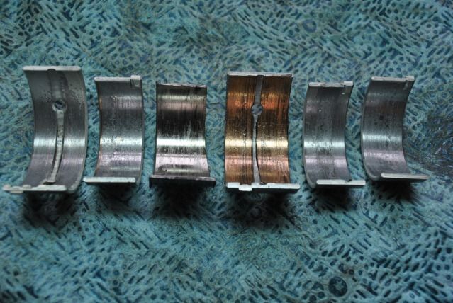

Bearings from left to right:- No1 main, Nos1 & 2 be, no2 main, nos3 & 4 be. Comments please :D
Crank and rods are ok which is good. Nowhere near as much swarf in the oil as before.

ermmm - wel oiling issues - but you thoroughly cleaned them out!
Another thought that comes to mind is,
Is the crank straight?
are the mains in line in the block?
does the block stregthening kit pull the centre one out of line?
I'm not an engine builder but if its the centre main this time, and was number three before, if the crank was out of line would that block oil flow to number three? and now be a little worse on the block distortion?
feel free to shoot me down, as I say I have little to no experience on this - just thinking aloud.

Looks like the centre main was first victim, then BE2 got most of the debris.
I agree with Sambo above....I'd be checking mains alignment (no crank) with the BSK torqued down before pointing the finger again at the oil supply. It might be the BSK spacer blocks do not belong to that block (ie not machined for that block)
Exactly what torques did you use for main studs and BEs?
EDIT: I assume the shells weren't mismatched (meant for a re-grind?).

the bearings were probably starved of oil when the crank pulley came loose as the skew gear on the crank would float drive to the oil pump and dizzy then become erratic as it went in and out of mesh

Post by Lotus-e-Clan » Sat Apr 28, 2012 11:47 am
GOOD POINT Ibbo! That's more likely given what happened!
The Woodruff key can easily come adrift too!

Whilst watching first practice both Ian Toon and I thought that the engine was rattling the last time it came by us before stopping. I would therefore surmise that the initial damage occurred then and that the majority of the damage to the bearings occurred during the running of the first race. I would still say that the initial damage is due to surge and based on experience it occurred at the downhill lefthand bend after the Gooseneck.

ibbo wrote:the bearings were probably starved of oil when the crank pulley came loose as the skew gear on the crank would float drive to the oil pump and dizzy then become erratic as it went in and out of mesh
I came to this possible conclusion earlier today. My focus was on the timing being retarded, not the driver (sorry, not the thought that the oil pump might not actually be spinning quite as well as it should).
benwick3 wrote:Whilst watching first practice both Ian Toon and I thought that the engine was rattling the last time it came by us before stopping. I would therefore surmise that the initial damage occurred then and that the majority of the damage to the bearings occurred during the running of the first race. I would still say that the initial damage is due to surge and based on experience it occurred at the downhill lefthand bend after the Gooseneck.
Pete Richards
Yes maybe. Or (and?) maybe the pulley clattering against the crossmember? Also the first time the pulley came adrift was on the road on Friday so perhaps this was a precursor. The bolt fell out altogether during practice allowing maximum pulley drift.
I think the chances of the crank being bent are minimal since it was freshly ground, furthermore I don't think the block was distorted at time of rebuild as I checked both be and main bearing tolerances with plastigauge and all was well.

Nick, i feel your pain - very disheartening, but at least on both occasions you've kept all the expensive bits inside the block :)
if the engine kept running with the pully loose then you can't have lost drive to the pump or the distributor would have stopped going round too. personally even if the pump was getting irregular speed from the gear floating then i can't see it causing a big problem, the pulses would be damped by the volume of oil in the filter and all the cooler pipework you have.
I think i'm with Pete R, either it's surge or a distorted block, assuming both failures have a common cause: then if the crank was freshly ground (between first and second failures? - to a good standard?) then you can rule that out.
Ibbo, are you saying that without a crank pulley bolt the oil pump can float in and out of mesh and the oil pressure can be erratic as a result....really? can you explain further please so I can get my thinking lined up?

I've been thinking a bit more about the pulley scenario.
I once misaligned a std pulley which (unknown to me at the time) pushed the Woodruff key upwards, out of it's slot and into the sump. The pulley was fully located onto the shaft and bolted well tight so the engine ran with no issues except the std TDC pulley mark was about 3 degrees out. It was a pulley from another engine so I stupidly thought that pulley QC must have gotten bad at some point so I recut a TDC mark.
Now if the same had happened to Melty but the pulley was run VERY loose, then the scroll could migrate off the second Woodruff key and the oil pump would stall also putting the timing out. IF this was the case, then there would be an issue getting the pulley to relocate all the way on the shaft 'cos the scroll would not realign by chance with the second key on the shaft.
A loss of a key should be easy to spot though so would expect Melty to have discovered this by now if it were the case.
Anyway, he can easily rule out the possibility of a floating oil pump scroll on full strip down.

allan the skew gear on the crank butts up against a hard shoulder on the crank butted up against the skew gear is the sprocket with the chain to drive camshaft both of these gears are a sliding fit on the crank drive is via woodruff keys the crankshaft pulley goes on last and in turn butts up against the sprocket hence if the pulley comes loose or worse in the case of meltdown bolt falls out there is nothing to keep everything butted up against the shoulder of the crank hence the pulleys move on the shaft this in turn means the oil pump can loose drive and the dizzy stop turning causing much popping and banging loss of power which happened to meltdown hope i havnt confused you more :D

ibbo wrote:allan the skew gear on the crank butts up against a hard shoulder on the crank butted up against the skew gear is the sprocket with the chain to drive camshaft both of these gears are a sliding fit on the crank drive is via woodruff keys the crankshaft pulley goes on last and in turn butts up against the sprocket hence if the pulley comes loose or worse in the case of meltdown bolt falls out there is nothing to keep everything butted up against the shoulder of the crank hence the pulleys move on the shaft this in turn means the oil pump can loose drive and the dizzy stop turning causing much popping and banging loss of power which happened to meltdown hope i havnt confused you more :D
Yep I reckon you're right Ibbo.
The skew gear just needs to migrate along the crank nose just enough for the oil pump gear to fall out of mesh...even if both keys are present the gears could still fall out of mesh temporarily without the skew gear losing drive from the crank.

This is where an eye-level large warning light connected to a high pressure switch would make it instantly obvious the pressure has gone awol. I must admit I haven't got one. Sensible to have one though cos there's not a chance you'd be looking at the oil pressure gauge at the right time.

should add the only thing holding the crank pulley on was the fan belt and that was only because the pulley was a deep alloy racing type had it been a standard one when the bolt came out the pulley would have moved the fan belt come off followed by the pulley then everything would really have been free to move on the crank

DT do a range 15, 25, and 30 psi ...I think mine must be 25 then not 20 psi.
DT high oil pressure switch

Hi. Unless the skew gear has ground out part of the timing case the pump will stay in mesh, just. Anyway once the pump is out of mesh the engine stops. Why are you loosing crank pulley bolts? nose of the crank worn? pulley worn? Oil surge is not the problem. Steve Platts is using the same sump/block plate setup without problems, running longer (and quicker!! :wink: ). This looks to me like a repeat of your Donnington occurrence ( with only a slightly different outcome) and you need to do a thorough inspection of all oil ways and associated components. (Especially around the centre main in the block). Cheers .Mike

I think it is not possible to rule out oil surge as the problem.. Steve Platts may use the same sump and plate with no problems but what about the other variables, the oil pump, standard or longer, and the position and type of oil pickup. These have to be taken into account when determining the cause of the problem along with the condition of the oilways etc. Unfortunately it seems that the Imp engine is susceptible to the type of failure described even when other engines to the same spec can continue for years with no problems.
As regards the 20psi low oil pressure light it will indicate when pressure is low as in the situation with a hot engine at tickover or a complete failure. As regards pressure loss due to surge I can assure you that the reaction time is too slow to pickup the minute fraction of time at zero oil pressure during surge. Similarly it will not be indicated by either an electric or capilliary oil pressure gauge. As I have mentioned many times before I was only able to recognise this problem when I switched to Pi datalogging and specifically logged oil pressure over a race period along with the other parameters.

/\/There's no denying that that's a distinct possibility. The pump is the longer one c/w spacer plate (and has a bronze gear) and the pickup is as supplied by Mike with the sump.
I have to cover as many bases as I can without knowing the precise reason and hope that I solve the issue. If it was the case of 'spinning on right hand bends' then I'd adopt the 'change one thing at a time' method.

why did the front pulley come loose ,also was this the pump that was in the last engine that let go ,and are you 100 % sure you cleaned any foreign body out of the engine when you rebuilt it as this failure has started with the main bearings and the last was the big ends , i cant see it being oil surge as most of the other lads are running the same sump set up and mike himself run it for a few years

Yes it is the same pump. I was indeed meticulous in cleaning. After my rebuild I adjusted the pressure relief valve and it was running at about 70psi until the trouble started.

Oh right i take it you measured the pump to check it was ok ,just very strange how you can have to major engine failures on the bounce ,also what make of oil filter are you running

It will certainly be measured this time!
