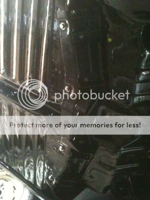

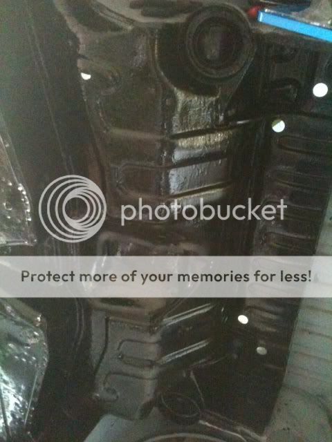

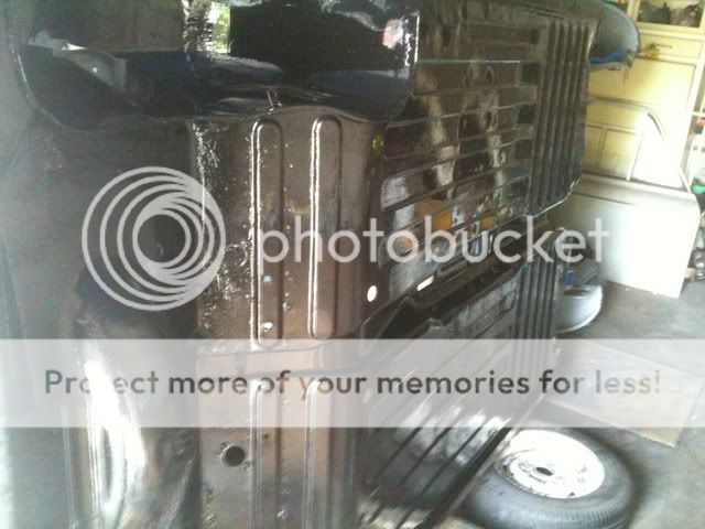

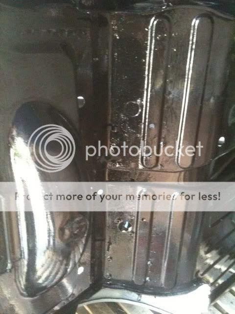

2nd coat of POR15 on........ blimmin good stuff 8) 8) just wear gloves when you apply :oops:
photos of underneath
Image Image
And I got the new powder coated cross member on 8)
sorry about quality of photees not great light in the garage :(
Right some questions ..... do you think I should now put some under seal over the top of the POR15 or should I just put a top coat of chassis black over it?
now to rebuild the suspension.... just got to save up and buy some shocks
Ben 8)
Two odd socks do not make a pair.

Hi Ben
Think you need to read the instructions re the use of POR15. If exposed to sunlight it reacts - not sure how and needs to be over coated, however because of its super smooth surface most paints won't stick to it so will chip/flake off easily. They do a prime coat which is an adhesion primer which allows a top coat to be used over the hardened POR15.
I would use an underseal as this will help with sound deadening and protect against stonechips, I am looking for some of the underseal used in new cars to use on my car but have not yet decided on which one yet.
Hope this helps.

Edit... from todays research the general concensus seems to be that you can over paint/ spray the POR15 with underseal but best to use POR 15 chassis black paint before the undercoat , plus you should rough up the POR15 rust coat paint first with 600 grit paper as it will help with the adhesion of next coat.
right going to be painting with chassis black when I get home then.
Ben :lol:
