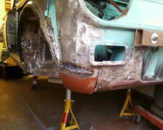

Post by colimp66 » Sun Aug 14, 2011 8:26 pm

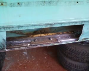

Thanks for the encouragement guys. . & after seeing all the great photos of the national my enthusiasm for The Pest has been renewed..
To prove it I have been busy grinding, cutting & welding today with some photos of my own although not quite as cool as some of the Imps from the national.. my own progress towards that event sometime in the future I hope. :wink:
I firstly removed the lower part of the front panel one as it was rusty :o & not attached to the panel behind it. Think it should be welded to this at the bottom of the panel. It wasn't.. :roll: It is now. :D
Before I cut it out I made a template for the new panel. After this was made the panel that the front one should've been welded to was beaten into shape & fitted along with a piece that I made way back when I last worked on the Pest.. for the bottom of the inner arch.
After these were welded into place I returned to the lower front panel once again......
That's where I am at the moment which will now allow me to continue with the outer front arch/wing... This is going to need a bit of fettling as it isn't the greatest of fits especially where it meets the sill & door.. This is what sickened me back in Jan/Feb so I hope it's ready to submit as I'm not going to admit defeat.... :lol:
Col.

How did you make the front lower panel section, Colin? I think I would try forming it around a steel tube but would be curious to know how you did it. :)
Fabulous work - as ever! 8)

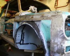

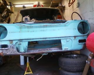

Post by colimp66 » Mon Aug 15, 2011 8:50 pm
Hi IM,
you are correct in the way you would do the front panel in the same way as I have done mine. I battered it around a pole I have in the garage. Sounds like you will nearing the bodywork stage for your Imp anytime now.????? I see you have been at it already?? Nice one.
Thanks Chris. Well done to you finishing Stella & picking up the trophies for all your hard work there. 8) Well deserved.
Never got a whole lot done today as it was my 8 year olds birthday party at the karting centre & I spent the afternoon there.. Good fun it was too. :D
Anyway by the time I got back from there & had something to eat I managed a few hours at The Pest..Buffed down my welds on the front panel repair & cut & trimmed the corner piece so I can fit the wing arch repair sometime in the week or ready for next weekend.
Image Image
Not 100% happy with how it sits but the best I could to do tonight. Will fettle it later & sure the filler that will be needed may sweeten it up someway.. when I get to that stage.
Col.

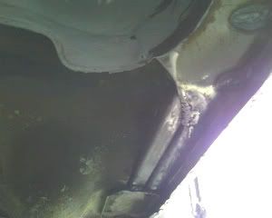

Post by colimp66 » Mon Aug 29, 2011 6:20 pm
It's not how far away it is Drew thats bothering me .. It's having the Pest finished in time for it that bothers me :lol:
Still, here is the progress so far no matter how slow I'm going it's still progress of a sort.

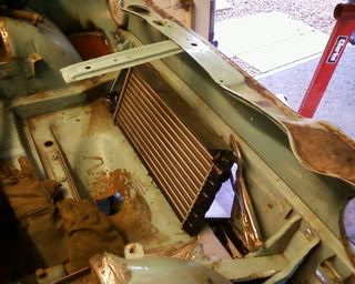

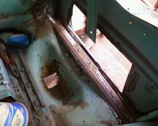

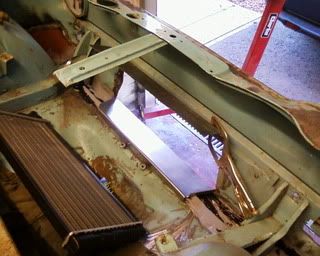

Finished of the inner arch at the bottoms front/rear so I can attach it solidly to the outer. Primed it with some Zinc 182 so now going to seam seal it inside & outside then another coat of primer.
Whilst the paint was drying I set about cutting out the heater intake at the front so I can eventually fit the Fiat Cinquecento radiator I recently bought. I want to strengthen up the front suspension mounts in this area too so it is good that the heater box is now gone.
Image Image Image
The rhs top suspension mount was also welded up along it's seams & a plate welded into the H bracket to keep it out of the elements way like the LHS. This was done before the painting :D .
Col.

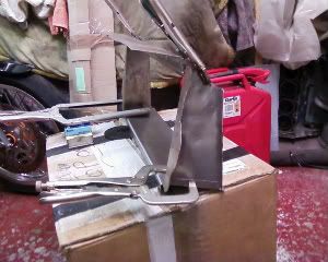

Cutting out the top of the fornt suspension mount support so i can weld in a 1"1/4 box section piece & tie it into the chassis rails at each side. Took a bit longer than I thought it would.
Cut out the piece I needed to & trial fitted the box section before removing & painting with some Zinc 182 where I wouldn't be able to paint once it was welded in..
Image Image
Once in & happy welded it all in then primed with Zinc 182. :D The underside can be seen in the second photo.
Image Image
Also seam sealed the rhs inner wing & that has now had it's second coat of primer.... shouldnt rust now..
That one is for Impmaniac :wink:
Col.

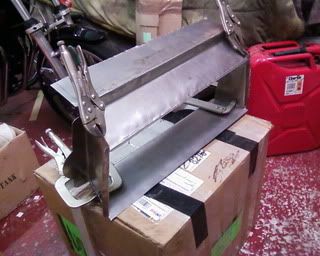

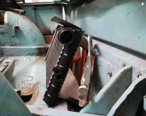

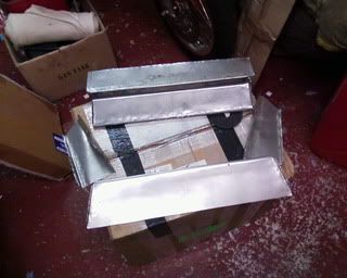

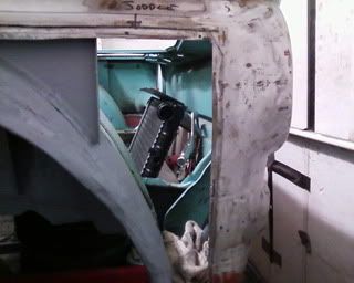

Two days in a row working on The Pest is unheard of lately but it has happened today with me working on the box for mounting the front radiator. I also seam sealed al lthe work I done yesterday on the strengthening of the front suspension mount.
After measuring it all up & do a couple of doodles on the box the radiator came in I was ready to start cutting & bending some metal.
The lower part was made up first with only needing two folds in it it was pretty straight forward but the height did concern me at first as I didn't want the radiator to be sitting on the edge of the suspension mount. I was thinking ahead of myself at this point & decided I would use the side plates that I haven't made yet to support the radiator using rubber exhaust mounts.
Image Image
The top panel to the box was a bit more of a challenge as it has a few more bends in it for attaching it to the body then to direct air to the raddiator & fold over the top so I can later mount the box to direct the hot air out through the redundant spare wheel well.
ImageImage Image
Tomorrow I will try & bend up the side plates that wil hold it all together & seal it so the air has to travel through tthe radiator.

Never managed to get into the garage at the weekend, well not to progress my Imp. Instead I was out playing on my motorbike that I have waited 8 weeks to get the V5 back from the DVLA so I could tax it.. It had to be done as the sun was out..
Anyway was in there tonight & finished the side panels for the radiator box so nearly ready for welding them in.. Thought I'd share the photos before it is welded up.
Image Image
In component form....
Col.

Post by colimp66 » Wed Jan 04, 2012 11:53 am
Well thats Christams & New Year over with, hope everyone had a good one?/
I have managed to have a bit of time on The Pest.. finished of the front wing at last & got it back on the spit so I can continue the task of repairing the floor, inner arch, outer arch, lower rear wing & the rear of the floor where the suspension crossmember bolts to... Seems all way too familiar that..??? ? :roll: probably a lot more besdies that little lot...
Image Image
Once the wing was welded & buffed down I got it on the spit.. & was greeted with this...
Image Image Image
Pretty much the same kind of state the lhs was in when I flipped that on its side. I think I can remember how to sort it out.. :lol:
Cheers.
Col.

Home from work last night & fired into the garage & cut out a bit of the floor & battered a fresh piece of metal into shape to replace it. Theres a few more of these to be shaped thats for sure but this is the first for now, more tonight I suspect.
Image Image
