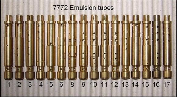

If you look at Emulsion No5 you will see that the profile is different to the No6. No 5 is has a reduced diameter to half way down the tube allowing more sustained fuel /air emulsification during low to midrange throttle openings compared to the No 6 -which suits an R17 which comes on cam earlier (3500 rpm) than hotter race cams. The second (holeless) half of No5 provides a quicker, richer progression as the throttles are opened (when the revs rise and the emulsion tubes empties completely) just like No6 (and the R17 can rev!!). Your VERY big air correctors (200) fitted to the top of the emulsion tube are needed to weaken the 132 main jets throughout the delivery and particularly during the final rich (holeless) phase of the No5 AND these big air correctors are essential to keep the AFR on target once the emulsion tube has emptied at WOT - otherwise the 132 mains would be too rich with smaller air correctors.
ie No5 emulsions are close bretheren to No6 but provides more sustained delivery of relatively weaker emulsified fuel - No 6 has a big hole at the top to weaken the VERY bottom end for race cams when off cam and empties more quickly than No 5 because it hold less emusified fuel so you get on to pure main jet metering much earlier than with the No 5
Compare to No 10:
I use No 10 emulsions (twin DHLA40) on a std 875 Imp sport cammed engine. Again a reduced diameter to half way with MANY holes sustains weaker emulsified fuel for longer which suits the progression of the sport cam which has limited rev capacity which means the engine is drawing less air so needs less fuel at the top end compared to race cams. Btw the twin 40 DHLAs on the sport engine work well and give 50 mpg (30 chokes No10 emulsion, 112 mains 180 airs, 40 idles),
Members & partners who like to knit go to http://knitowl.co.uk
