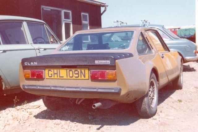

The std Clan on skinny 155 tyres with 1+inch spacers as shown in this period photo. With spacers, there is potentially more strain on the rear hubs compared to a normal Imp but there is less weight at the rear than an Imp for the suspension and hubs carriers to cope with. The soft std Clan suspension settings means it transfers quite a lot of it's weight onto the outer gripping tyres - so via specific suspension settings the Lotus guys got as much grip as possible out of the skinny tyres and consequently the Clans wet grip was applauded by contemporary road testers.
Note there is not a lot of "inboard" rubber over the hub.....

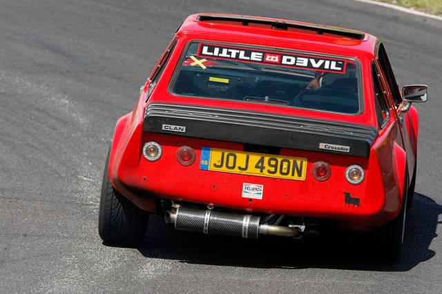

...compared to the Clan with 205/50/13 on 8 inch rims and a 25 mm offset (no spacers). These bring more rubber inboard (over the hub) as well as outboard compared to std. Strain on the rear hubs is certainly no more than the std Clan with spacers and I believe it is probably less going by the dramatic reduction in rear bearing wear over the 6 years since fitting these wider wheels and tyres. So pay attention to rear wheel OFFSET:
.. initial suspension settings gave plenty of roll even on uprated rear springs (Imp) ... I had plenty of rear grip but relatively low front end grip which resulted in too much understeer. :shock:
....and here is an old pro demonstrating that proper weight transfer front AND rear gives good turn-in 8) ... note his calm and content expression ... very much in control ..almost bored infact :lol:
.... a very light car on wide rear rubber albeit a soft trackday compound (AVON CR500 205/55/13 rear 175/55/13 front) . The suspension settings are set-up to work with the low weight and available grip from the tyres. 8)

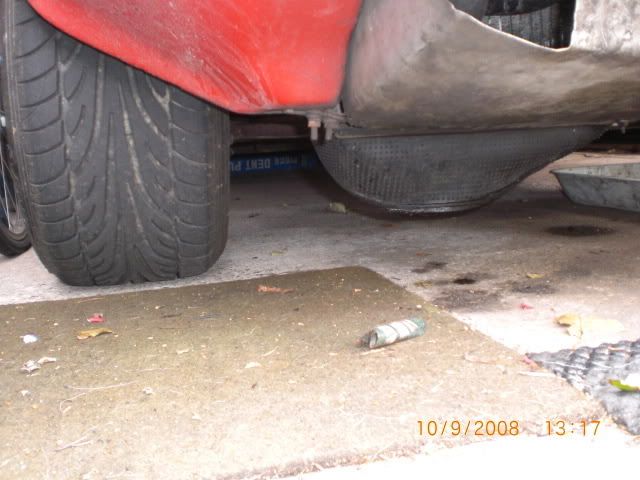

Postby Dogsbody » Sat Feb 23, 2013 1:01 pm
This dosen't look much at first glance as the car is almost flat.
But look at the angle of the air freshener hanging from the mirror and the front tyre exposing the rim where its under stress.
Standard suspension as it left the factory.
The LSD sorts out understeer :wink:
